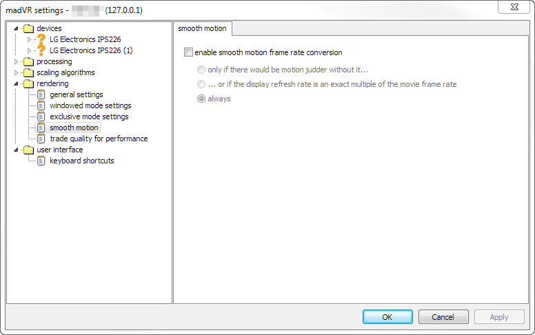

how to access the madVR settings to turn that on?
Re: SVP and madVR Smooth Motion
berryracer
1. Download last madVR, unpack, run install.bat.
2. When playing in MPC-HC: Play - Filters - madVR - Edit Settings
http://www.svp-team.com/forum/misc.php?item=2371
madVR_smooth_motion.png, 12.63 kb, 776 x 486
