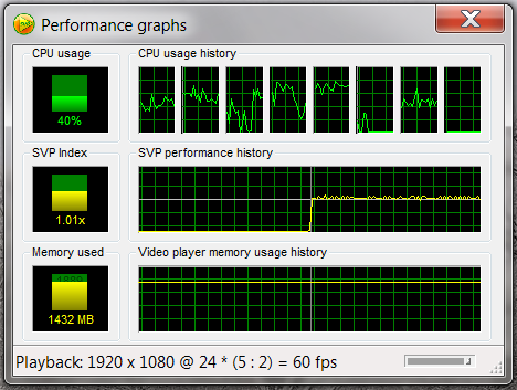

In the attachment you can see an image of my performance graph.
Please let me know if you need some other info...

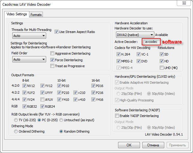

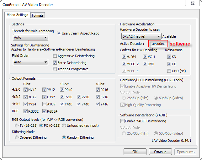

Re: Problems playing 1080p videos
xcloudx
Maybe DXVA2 native is not enabled?
http://www.svp-team.com/forum/misc.php?item=2179
Is_DXVA_enabled.gif, 38.41 kb, 644 x 510
In fact, it's "available", but Active Codec is avcodec. So it seems it's available but not setted...
xcloudx
Ok. Thank you. It is clear to me now why DXVA2 native is worked to you smile
It is fall-back software decoding. LAV has one of the fastest software decoders. You can continue to use it without any problems.
