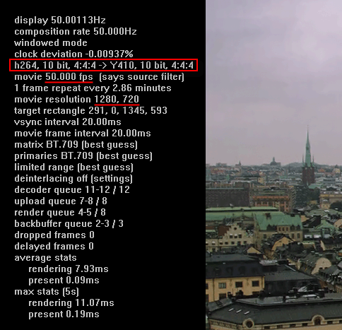

I looked at one of hard cases: AVC Hi10p 4:4:4 (50fps but only 720p)
H.264-444-10bit-sample (1,4 MB)
It showed 30% of CPU usage with ffdShow decoder and 25% CPU usage with LAV decoder. Hi10p decode now is software only.
CPU: Core i5-2300 2,8 GHz
http://www.svp-team.com/forum/misc.php?item=2054

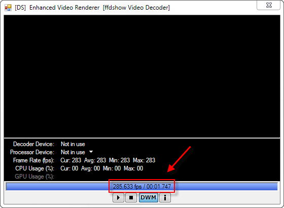

You can check maximum possible speed for this file by DXVA Checker: Decoder Device tab - click Check DirectShow/MediaFoundation Decoders button - point to H.264-444-10bit-sample file - Open - press at triangle near decoder name - Benchmark - EVR
Results of Core i5-2300 2,8 GHz:
ffdShow: 285 fps
LAV: 260 fps
http://www.svp-team.com/forum/misc.php?item=2055
It is pure decoding without SVP processing.
For 25 fps play at normal speed it will be only 10% (25/285) of CPU using for decode. Other 90% will be available to SVP. It will be enough I think wink
