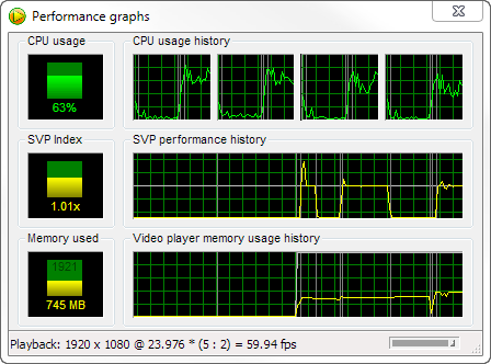

4. Look at performance graphs window. How many memory used by player while it crashes (in MB)?
Take screenshot please like this.
http://www.svp-team.com/forum/misc.php?item=1978
Please answer all questions: 1, 2, 3 and 4.

Re: Windows 32-bit - runtime error (out of memory)
1. I think I set the wrong test
2. I use windows 7 32 bit, 4 gb of RAM
3. yes, but do not know its size
4. http://img818.imageshack.us/img818/9123/screen2sr.png

vayra
Then you have only 3GB available in the system.
SVP graph window shows only half of used memory. Really used memory size is greater by two times. It is around 2,8 GB.
So C++ error tells you what your free memory is not enough.
You can:
1. change parameter "Motion vectors precision" to "One pixel" to reduce memory use.
2. install Win7 64bit to use full memory size.
3. wait for SVP 3.1.3 with memory use optimizations. Or you can do optimizations manually. I can explain how.
Pagefile is harmful for SVP when you have lack of memory. You potentially will have lags at video while pagefile swapping. But it is not your case. SVP-index=1. It is good.
