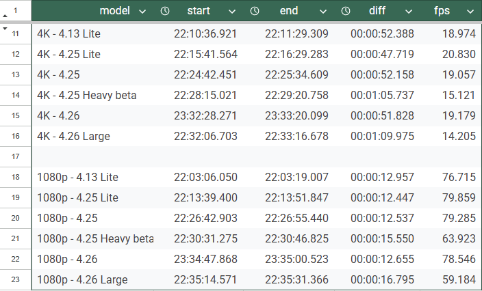

Has anyone tried this with a Radeon RX 9060 XT? If so what is the performance? The wiki says in order to interpolate videos in 1080p 60fps you need a RTX 3080 which I believe is better card than RX 9060 XT but I would like to know if someone has actually tested this.
THIS is mostly for NV cards, bacause generic Vulcan RIFE is 2 times slower than RIFE for TensorRT
Not sure if this will be useful to you, but I measured performance with the 9070XT. Here are the results for transcoding a random stock video using different versions of RIFE, of course only at x2. Overall, for FHD, that’s more than enough.
RIFE also worked fine on the 5700XT, but the maximum resolution was only about 1520×855. smile
Снимок экрана 2025-11-13 003649.png, 72.15 kb, 704 x 426
