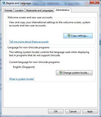

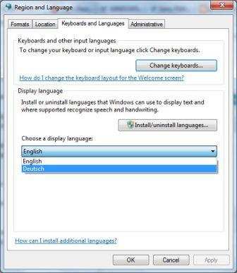

Re: Waiting for ffdshow video (User name in Chinese)
lkk_12342001
Can you tell me what Display Language in your Win7 and what current language for non-Unicode programs?
change-display-language-for-windows-7
http://www.svp-team.com/forum/misc.php?item=1780 http://www.svp-team.com/forum/misc.php?item=1781
display_language.jpg, 27.7 kb, 336 x 387
language_for_non-Unicode_programs.jpg, 28.96 kb, 336 x 387
lkk_12342001
My display language is Chinese (Traditional,Taiwan) and current language for non-Unicode programs is the same.

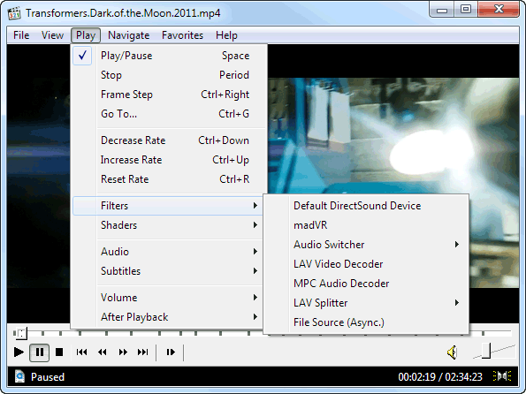

SVP-manager must be close but it continue its work. It is strange. But it is not cause of performance difference between users.
Check GPU-acceleration (OpenCL): true in both cases.
And look at filters list in both cases. You must find differences there. I think it is decoder and renderer.
http://www.svp-team.com/forum/misc.php?item=2069
We have some international improvements in SVP 3.1.3 beta and we need to test it.
Would you like to become international SVP beta tester? smile
MPC-HC__Filters.png, 29.75 kb, 595 x 446
