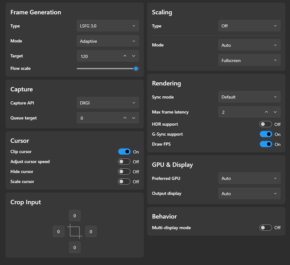

2,302 (edited by RickyAstle98 12-03-2025 06:06:34)
Drakko01 wrote:
Any combination I try with LSFG +Rife its not given me better viewing experiences  that Rife x3 or x4 on my tv, maybe I doing something wrong or some setting/program or parameter in my config its interfering.
Looks like LSFG doesnt capture your frames properly, enable Draw FPS and you will see (captured frames / displayed frames) for example!
If you see 120/120 means LSFG detects your monitor refresh rate instead!
Close overlays like Steam, Discord, NVIDIA, everything!
Open video through mpv and press F (to go fullscreen) then Ctrl+Alt+S hotkey!
The behavior might look like > 48 / 120 (RIFE x2 for example)
LSFG.png, 47.63 kb, 930 x 850
