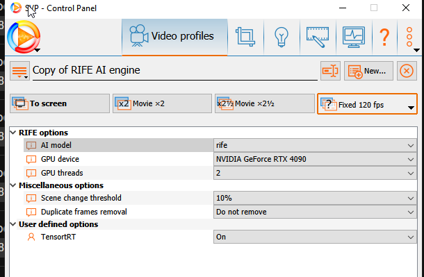

grobalt wrote:
I deleted SVP and startet from scratch, just to check if the inscructions are complete and everything is working.
There is a step missing.
After replacing generate.js and base.py, start SVP4, add the new option TensorRT etc.
Then the missing step:
Copy the Rife AI profile and select the AI Model "rife"
Enable the new Option TensorRT On
This is a good solution. Start from scratch and describe all the steps that are missing.
In other words, create some instruction for a completely new person so that they do not get lost.

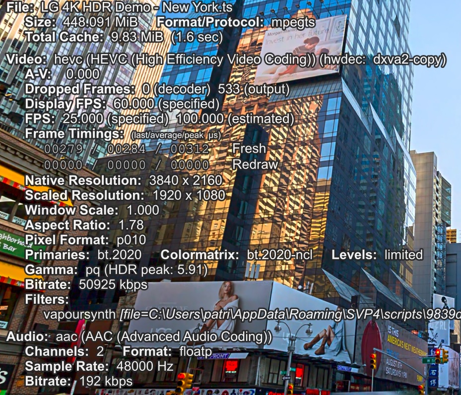

484 (edited by grobalt 09-01-2023 21:28:32)
What alola wrote the last days has just be to wrong .. impossible the results for his 3070ti with the old script.
DragonicPrime is something odd as well.
I can go MPV HDR on and OFF (Try to recover HDR colors) with frame doubling without dropped frames with a 5600x and RTX4090.
Now i need to figure out how to get that stuff integrated into a MadVR Player smile
The LG Demo File is lagging (about 2900 dropped frames at output for the full clip), 3 Rife Threads. No performance difference HDR on and off setting.
dont understand why the LG file is causing issues

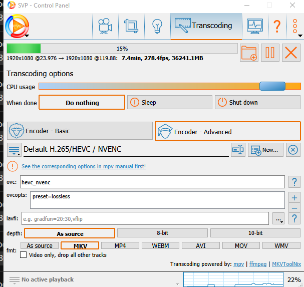

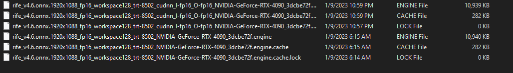

492 (edited by Pezede 09-01-2023 22:07:03)
I've done a reinstall of SVP and I'm now getting ~280fps on 1080P transcoding with the new guide, that seems almost miraculous...
I've gotten the console window and there are lock files in the rife folder so it seems to be used.
Hardware is 4090 paired with a 7950X and DDR5 6000 ram.
Alrighty, this worked! Now it looks as smooth as with mpv-lazy, might be smoother looking at what you guys are saying, but cannot check since I am capped at 1080@60.
so to do real-time 4k you need really good RAM bandwidth first, then GPU and CPU last, since my CPU usage is very low.

my display is 60hz at my pc, so output drops everything above 60fps.
multiplied by 4 is running smooth with 1920x1080 downscaling
