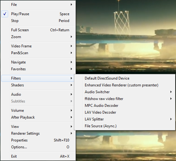

I did it!
I can watch this intro without drops with fne smoothness. I do it in MPC-HC. Because I have not 3D glasses.
To avoid drops I had to change Haali splitter to LAV splitter.
http://www.svp-team.com/forum/misc.php?item=1876
I test it with movements of orange line in tearing test (Ctrl-Win-T). I can get 120 Hz with perfect smoothness.
Now I can use LAV CUDA CUVID hardware decoder.
There are 3 renderers are drops free for me:
1. EVR Custom
2. EVR Sync
3. madVR
Additional Info:
Filename: Transformers intro.mkv
Frame size and frame rate: 1920x800 pixels, 23.976 fps
After resize: 1680x700 pixels
Detected screen parameters
Screen size and refresh rate: 1680x1050 pixels, 119.995 Hz
Video smoothing info
Smooth factor: 5:1
Resulting video frame rate: 119.88 fps
Repeat 1 frame every 8.7 sec (without ReClock)
Selected profile: 1920x800@24
[ExMethod=MSmoothFps_3]        Frames interpolation mode: Adaptive (default)
[ExAlgo=23]            SVP shader: 23. Complicated
[Bicubic=1]            Motion vectors interpolation mode: Bicubic (by default)
[ExBlockSize=16x16:2]        Motion vectors grid: 12 px. Average 2 (default)
[ExRecalc=0:0]            Decrease grid step: Disabled (default)
[TypeDist=Exh:-10:SATD]        Search radius: Average (default)
[Badsad=2000:-24]        Wide search: Strongest
[ExDwnResize=MON]        Decrease frame size: To screen size
[ExConvertFps=false]        Blend frames to screen refresh rate:false
Settings by menu
[Borderlight=None]        Black bars lighting: Disabled
[EFrameDoubling=0]        Variable frame rate repair: false
[StopSmoothDelayOnRewind=1]    Turn off on seek: Turn off by 1 sec
filters.png, 224 kb, 569 x 520
