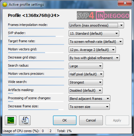

Hmmm this is odd, I'm having some conflicting results with regards to simulating your CPU performance...
Well, let's give it some real-world testing then!  Try these settings - don't be surprised if they're too much for your system though.
If it is too much for your PC, please look at the performance graph in SVP (right-click SVP icon, Information -> Performance graphs) and tell me what the "SVP index" is.

Obviusly the playback is horrible with these settings. The index is 0.68 0.70

OK I figured - turns out that "Fast SVPmark" is horribly inaccurate since I was only getting a value of around 650!

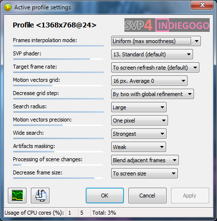

Ok, now if my math is correct, these settings should be usable.
Since you seemed to be pretty OCD about artifacts, I prioritized having "Global Refinement" and also threw in some weak artifact masking as well.
Again, same thing, if it's still too much then tell me your SVP index and maybe your CPU utilization.

With these settings the cpu utlization is 95% and the index is 0.95. So the playback is tooo slow T.T
You have D3D Fullscreen enabled in MPC-HC, right?
If that still isn't enough, set artifact masking to "disabled" - that should gain you about 5% CPU utilization.
You might be able to also gain maybe 2-3% by setting "Processing of scene changes" to "Repeat frame".
Also you could try setting "Search radius" to 'Average' which may gain you another 2-3% of CPU utilization.

With these adjustments the cpu is 80% 85% and the index is 1.00 so the playback is fine.
