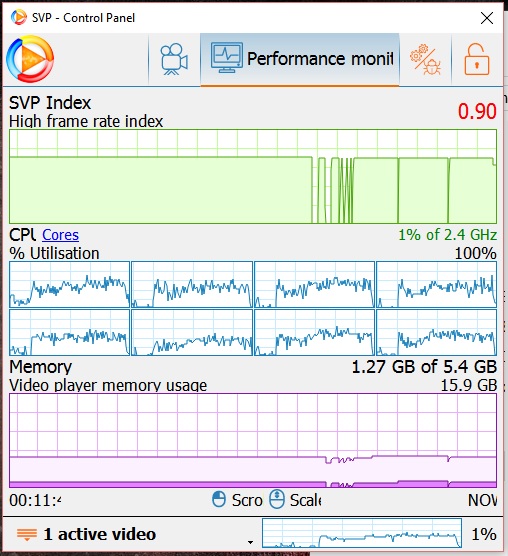

I'm having some issues myself, although the CPU usage doesn't seem to get at 100%, but the playback is not smooth.

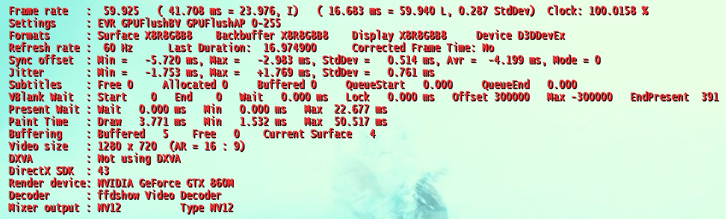

It looks like it's dropping frames and constantly, more so on complex scenes, but fraps shows constant 60 fps, so that's weird. I really don't understand what's going on.
My specs are: Lenovo Y50, i7 4710QM 2.4GHz, 16GB DDR3L and GTX 860m 4GB GDDR5. I think it should be more than enough to run SVP at smooth 60 fps.
IDK what url to put in the img tags to upload images, I wanted to show you the EVR OSD and the SVP performance monitor.
edit: I'm using SVP free for now, as I want to make sure it works fine on my system first and if it does, I'll def buy the premium. I messed up with all the settings I found, changed all processing threads and such. Didn't change the application settings as I don't really know what they mean and can't even read the whole description.
I use EVR and now made it select the dedicated graphics, but no change. I tried madVR and the fps is horrible in full screen for some reason, even with all "sacrifice quality for performance" boxes ticked. I have attached the graphs. One is displayed and the other only shows as a link, have no idea why.
svpgraph.jpg, 108.5 kb, 508 x 556

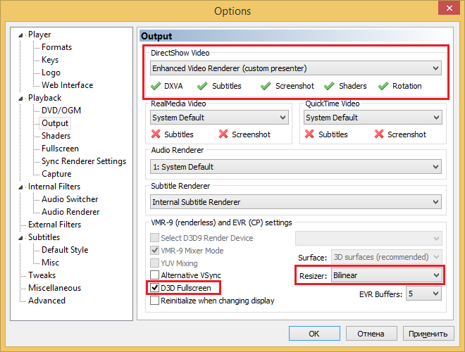

1. Use EVR custom with D3D Fullscreen option enabled. And choose Resizer without PixelShaders (PS): MPC-HC - View - Options - Output
2. Remove all pixel shaders from both lists (pre-resize and post-resize): MPC-HC - Play - Shaders - Select Shaders

I actually answer that question regarding processing threads, if you read carefully I said I tried all of them.  In MPC-HC I was already using EVR custom. I did change the resizer to bilinear now and checked the D£D Fullscreen and it does look better, less stuttering but it still stutters sometimes and doesn't look that fluid, before it looked more fluid when it wasn't stuttering, but was stuttering alot.
Should I use my dedicated graphics to run MPC-HC or internal? and what GPU acceleration for SVP? EVR custom OSD shows it's not using DXVA, no matter which graphics it's using.
If your video is not 8bit AVC/h.264 then that would be expected.  This will therefore result in higher CPU utilization.
Also, if your video is 10bit AVC/h.264, HEVC/h.265, or VP9, then decoding it will take even more CPU utilization.

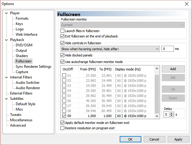

I said before that CPU utilization never reaches 100%, around 50% mostly. Also it seems if I have D3D checked in MVC-HC, when connected to my projector, in full screen it changes my resolution to 1080p and refresh rate to 59 I think, which makes my screen smaller. That's something I don't want.

Also it seems if I have D3D checked in MPC-HC, when connected to my projector, in full screen it changes my resolution to 1080p and refresh rate to 59 I think, which makes my screen smaller. That's something I don't want.
That to me sounds like the fault of MPC-HC's automatic resolution changer and not D3D fullscreen.

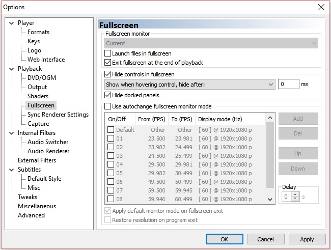

Yea, I think that MPC-HC is changing the resolution, but how do I fix that?
On the fullscreen settings the use autochange fullscreen monitor is unchecked. I tried with that and checked it, unchecked all modes and added the one for the projector, just clicked the add button and was there, 1280x800 6Hz, but it didn't do anything, it still changes the display mode. I'm not sure exactly what that does, but the screen size is smaller and the image is washed out, looks really bad.
Any way to stop it from changing the display mode in full screen with D3D checked?

mpc1.jpg, 114.28 kb, 650 x 491
mpc2.jpg, 118.45 kb, 648 x 488
