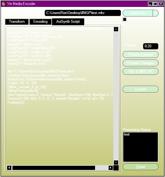

Yeah, it's really quite hard to see the script text with the background image (see attached screenshot).
Mystery wrote:
The next version will have further changes that will considerably improve frame interpolation results.
Wow, have to agree. The issue is that parts of the layout is speficied by my application and part by the OS. Best option might be to override everything.
